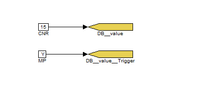

Maybe you could use an input field and use a separate 'SET'-button to write this value to your database by using an additional auxiliary signals __Trigger (page 10 of DbDrv_ENG.pdf).
#3 2016-07-14 21:53:25
scoobsalamander
From: Belgium - Hulshout
Posts: 217
Re: Database
I have no idea how to use this __Trigger but I guess it is something like this :
I can not test it myself at the moment so....

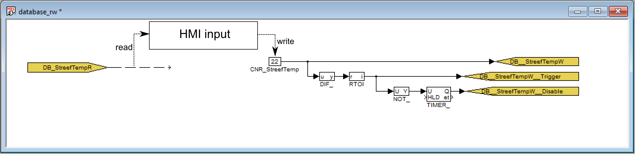

I see your point - you want to use it as some kind of persistent memory, right?
This can be done using database, but you need to be careful about handling with read / write commands from / to database as I already mentioned. Following picture shows how it can be done in REX. It uses triggered writing to database on signal change (change from HMI input) by auxiliary flag. You will need to reconfigure your HMI according to the picture - read target temperature from DB flag and write it to constant CNR_StreefTemp.
You also need to change your .rio configuration file to read and write to the same item in certain database table.
There is one drawback I'm able to think of now - the value in HMI will remain for a while unchanged after you edit it manually because it takes some time to process the value to and from database. This can be a bit confusing.
Please, take it as a hint. It's not a working solution since I don't have any hardware available to test it on by now hmm

I prepared a solution of this problem without the delay of value change in your HMI. Please, download the sample project.
In order to make it work you need to change HMI connection strings of the temperature to both read and write from / to "CNR_StreefTemp". If you will change the value manually (in HMI or directly in "CNR_StreefTemp") the value will be written to the database as well. If the database writing fails for some reason it will change the value of "CNR_StreefTemp" back to that one stored in the database. This means that after blackout is should automatically read the value from database and set it to "CNR_StreefTemp" as well.
Feel free to contact me if you will have any questions regarding this solution.
