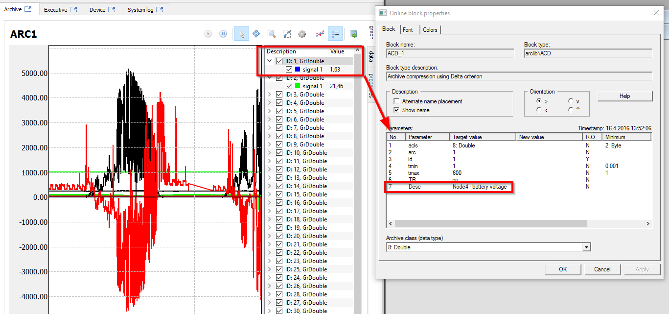

Trends in RexView
Is it possible to get the description, as assigned in the ACD block, in the signal table next to the trend view in RexView?
Is it possible to (de)select all signals with one single mouse click? (..and/or selecting by dragging the cursor over a part of the list)
#2 2016-04-18 13:34:47
Re: Trends in RexView
Hello scoobsalamander,
thank you for your questions and valuable feedback! Displaying description of channel in RexView is not implemented yet and is a future feature.
Currently, it is not possible to de/select all signals at once. I can see your point especially with use of large archives and vector trend (TRNDV). You can use a little workaround with arrows (up and down) and spacebar which de/selects the current channel.
