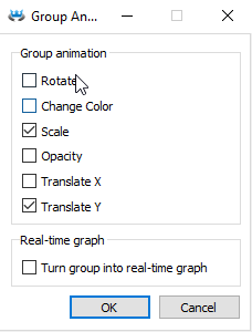

It seems to happen only on components with a 'group animation' where multiple selections were done....
...or where a 'display' component is used in combination with a 'group animation'.

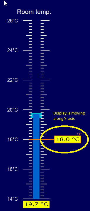

In the mean while I did some more testing and it seems to be also with components with only a single animation. I have the impression that the objects I am willing to control along the Y-axis are sometimes way off on the Y-axis after the process value has changed. After refreshing the page it all turns back to normal until another change of the value. On the same HMI I have also a component which is being scaled and this is working fine. (also colour changing is working)

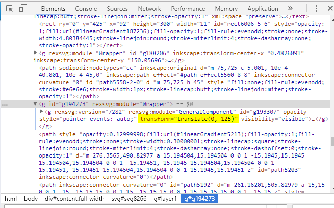

I tried your example and it is working fine in my browser. Then I tried the -300 setting and it is working but only after changing the value in REXcontrols....and after a refresh it is again offset....so actually just the opposite from what I noticed before.
When I decrease the width of my browser to only half the size of my monitor I get some space on both sides of the window and then I can see the disappeared triangle on the bottom of my screen.

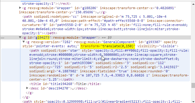

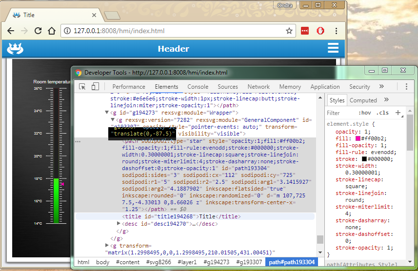

The animation of the object is done via changing the transformation attribute of the SVG group. Can you check using the Developer tools in Chrome or Firefox what is the value of the transform attribute.
It seems that the sign is changing somehow after refreshing the page and/or refreshing the value in REXcontrols.
After refreshing the page it becomes positive and when I change the value then it becomes negative again.
