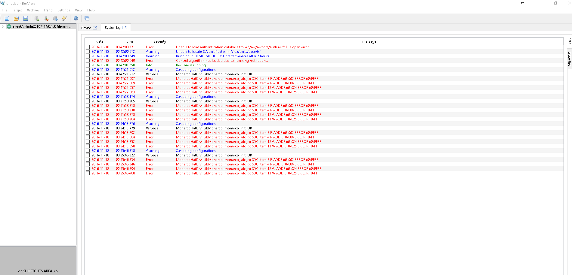

Monarco HAT System Log Error + AIN Flags difference
Dear Rex Control,
yesterday I tried to install Monarco HAT on Raspberry Pi2 with latest OS RASPBIAN JESSIE WITH PIXEL after apt-get update and upgrade. The installation of the Monarco went through without errors and I was also able to upload compiled executive and connect to it using both RexDraw and RexView. The running executive was using two AIN and two DOUT as PWM and was doing its job. Despite the executive was working fine I noticed following error in the system log:
Could you please explain what exactly this error means?What should be done to get rid of this error?

Dear hondzeek!
You probably have one of the very first Monarco HAT boards which we've sent to testers with firmware version 2.3. This version does not have implemented some minor features and service registers which cause errors you can see in the system log - the messages just inform you that read/write of several registers failed. If you are interested in deep, you can find service registers description in the doc: https://github.com/monarco/monarco-hat- … escription
It should not affect any functions except switching COUNTER modes. In firmware 2.3 COUNTER1 is fixed in quadrature mode, and COUNTER2 is disabled.
During this week, we will release firmware-upgrade tool so you will be able to upgrade firmware to the latest version in your Monarco HAT. Thanks for patience.
