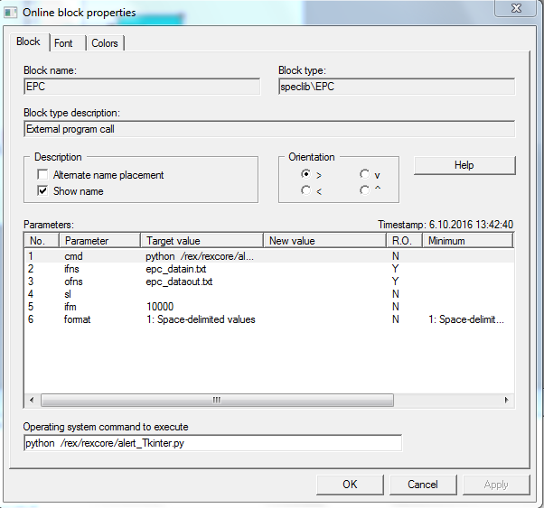

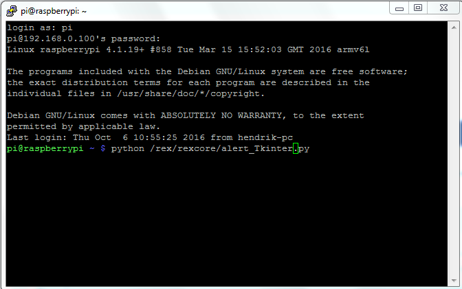

I have created a few Tkinter scripts and I can call it with cmd (Unipi). I attempted to call it with the epc block but it does not work. According to the log the problem lies with the way I named the file?

I have renamed ofns to "epc_datain.txt" and that seems to have cleared the error messages but I still cannot call the Tkinter script or any other script.

The EPC email notification example did not work for me; I found that I had to change "headers = ["From: " + MAIL_USERNAME," to "headers = ["From: " + SMTP_USERNAME, "
as mentioned before I had to change ofns from "epc_dataout.txt to "epc_datain.txt". I am now able to sent emails, again, when using the EPC block, thanks.
See attached basic test script for Tkinter which does work when using cmd in terminal but not when using the EPC block.

The EPC block is meant for running non-interactive scripts, which only take the input data, process it and generate output data. Running interactive scripts waiting for user input (confirmation of the alert) is not recommended. Anyways, the problem is that RexCore is running in the background as a service and therefore neither RexCore neither the script knows where to display the window/dialog.

I have set cmd to
su pi -c "export DISPLAY=:0.0 && python /rex/rexcore/alert_Tkinter.py"
and it works for me, the window appears on the HDMI screen. However, the RESET input of EPC does not work in this case.
