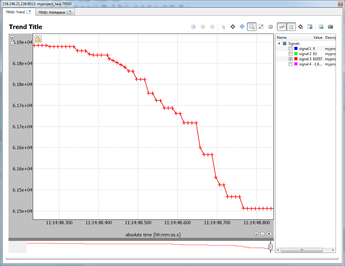

Hi Jaroslav,
I checked err_code and err_subcode and there were zeros.

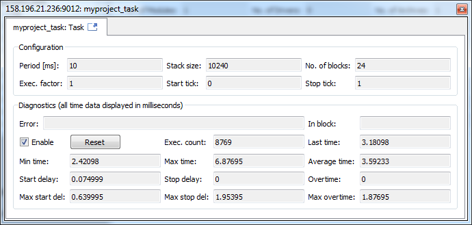

I tried to rotate it manually, but i am not sure if I was able to rotate it with constant speed. Still problems with counter value, see attached picture.
I also attached diagnostic window screen, average time was 3.59 ms and maximum 6.87 ms.
Regards
Bodie

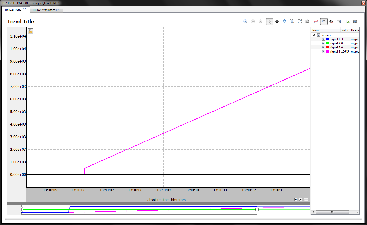

Hi Tomas,
Yes, as you wrote, I checked it in trend.
The userRecv trend is attached, looks like it is rising linearly.
Regards
Bodie
