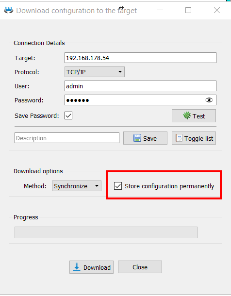

The problem is that after a reboot there seems to be no running project anymore. When I connect/watch in REXdraw the windows are grey colored as usual but I cannot see any values only question marks. Conneting with REXview seems to be possible but their is not project to be seen.....
After a new compile/download everything is fine.
....OK...think I found it.
This box should be ticked, correct...? Don't know why it was unticked...but it seems that after a reboot I have a running project again.
(I never paid any attention to this box....until now.. :-) )
Hi Scoobsalamander,
you are right. By default it is unticked because in the demo version it is not allowed to store the algorithm in the target device. You can only download it to RAM memory and run it for 2-hours. And it's also good for the lifetime of your SD card...
