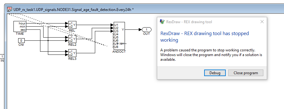

REXdraw chrashed during deleting unwanted ports
I created a subsystem which contained an ANDOCT block. After the creation of the subsystem I started deleting all the unwanted ports which were automatically created by REXdraw. During this deleting the program crashed several times...
The two diagonal dashed lines showed up during this crash...every time the same. If I delete the ports slowly then I don't have this problem it was only when I was trying to do this rather fast smile

thank you very much for reporting this bug! I would like to assure you that lines and connecting FBs will be completely revised in new release (not only because of this issue).

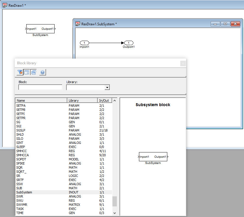

PS: Creating a SubSystem: if there are more unwanted ports then the wanted ones (almost always in my opinion wink ) you can use this workaround of creating SubSystem:
- open Library and add to your project "SubSystem" block - this will lead to SubSystem with one inport and one outport
- draw the SubSystem you need
