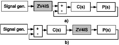

The input shaping filter can be used in two different ways. By using an open loop connection, the input reference signal for an feedback loop coming from human operator or higher level of control structure is properly shaped in order to attenuate any unwanted oscillations. The internal dynamics of the filter does not influence a behaviour of the inferior loop. The only condition is correct tuning of feedback compensator C(s), which has to work in linear mode. Otherwise, the frequency spectrum of the manipulating variable gets corrupted and unwanted oscillations can still be excited in a plant P(s). The main disadvantage is passive vibration damping which works only in reference signal path. In case of any external disturbances acting on the plant, the vibrations may still arise. The second possible way of use is feedback connection. The input shaper is placed on the output side of feedback compensator C(s) and modifies the manipulating variable acting on the plant. An additional dynamics of the filter is introduced and the compensator C(s) needs to be properly tuned.

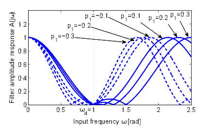

The asymmetry parameter p_alpha determines relative location of the stopband of filter frequency response with respect to chosen natural frequency. Positive values mean a shift to higher frequency range, negative values to lower frequency range, zero value leads to symmetrical shape of the characteristic (see the figure above). The parameter p_alpha also affects the overall filter length, thus the overall delay introduced into a signal path. Lower values result in slower filters and higher delay. Asymmetric filters can be used in cases where a lower or higher bound of the uncertainty in natural frequency parameter is known.

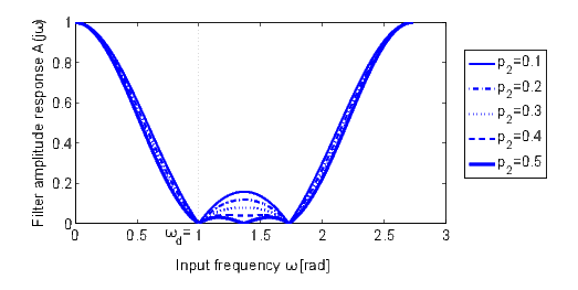

Insensitivity parameter p_a2 determines the width and attenuation level of the filter stopband. Higher values result in wider stopband and higher attenuation. For most applications, the value p_a2=0.5 is recommended for highest achievable robustness with respect to modeling errors.

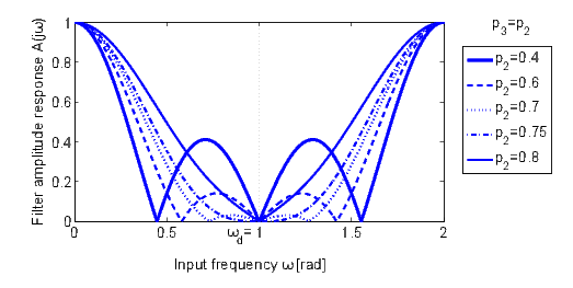

The additional parameter p_a3 needs to be chosen for symmetrical filters (p_alpha=0). A rule for the most of the practical applications is to chose equal values p_a2=p_a3 from interval <0,0.75>. Overall filter length is constant for this choice and only the shape of filter stopband is affected. Lower values lead to robust shapers with wide stopband and frequency response shape similar to standard THEI (Two-hump extra insensitive) filters. Higher values lead to narrow stopband and synchronous drop of two stopband peaks. The choice p_a2=p_a3=0.75 results in standard ZVDD filter with maximally flat and symmetric stopband shape. The proposed scheme can be used for systematic tuning of the filter.
