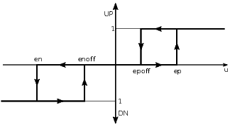

The TSE block transforms the analog input u to a three-state signal ("up", "idle" and "down")
according to the diagram below.
Input
u | Analog input of the block | Double (F64) |
Outputs
UP | The "up" signal | Bool |
DN | The "down" signal | Bool |
Parameters
ep | The input value u>ep results in UP=on and DN=off ⊙1.0 | Double (F64) |
en | The input value u<en results in UP=off and DN=off ⊙-1.0 | Double (F64) |
epoff | UP switch off value; if UP=on and u<epoff then UP=off ⊙0.5 | Double (F64) |
enoff | DN switch off value; if DN=on and u>enoff then DN=off ⊙-0.5 | Double (F64) |
