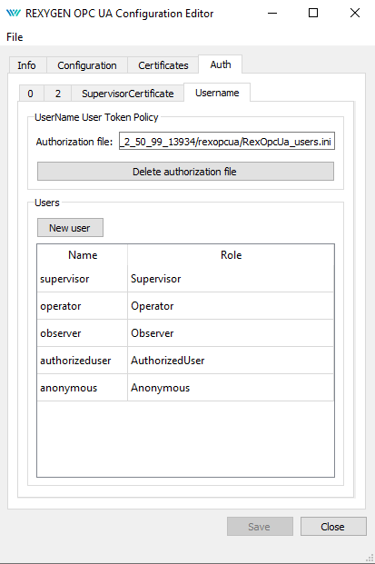

5 Authentication and authorization
5.1 Roles and users
5.2 Credentials INI file

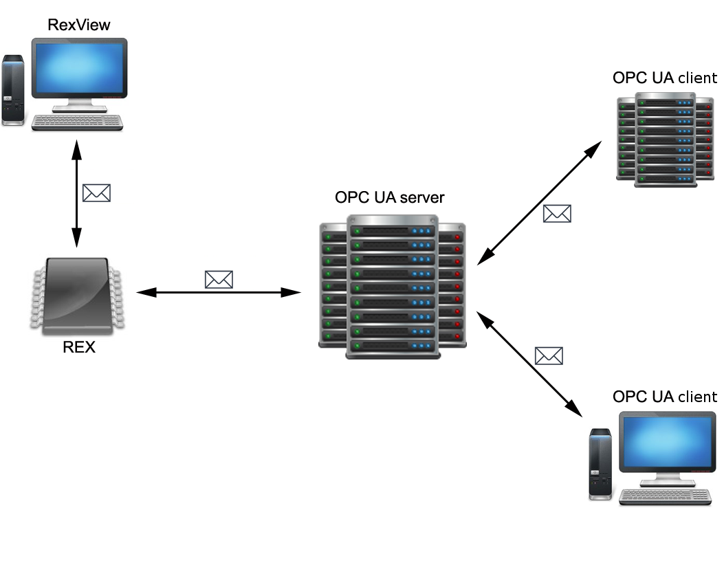

OPC UA server for REXYGEN is as standalone application that is connected to a REXYGEN runtime utilizing a low-level diagnostic protocol. It is not required to run the OPC UA server on the same station where the REXYGEN runtime is running. However, it is advised to run the OPC UA server as close to the REXYGEN runtime as possible to minimize latencies. The OPC UA server for REXYGEN implements the opc.tcp communication protocol, that is the most common protocol for OPC UA servers that acquire data from real-time control devices. The connection of OPC UA with client applications is shown on figure 1.1.
The OPC UA server for REXYGEN has to be licensed properly when it operates in an industrial environment. It is also possible to run the server in a so called DEMO mode, in which the server is fully functional but terminates after one hour without any notice. Licensing of the OPC UA server is performed by obtaining a valid license key and registering it either by using REXYGEN Studio or by setting the REX_LICENCE_KEY configuration parameter in the configuration file (see chapter 4.4.2).
1.3 Provided functionality

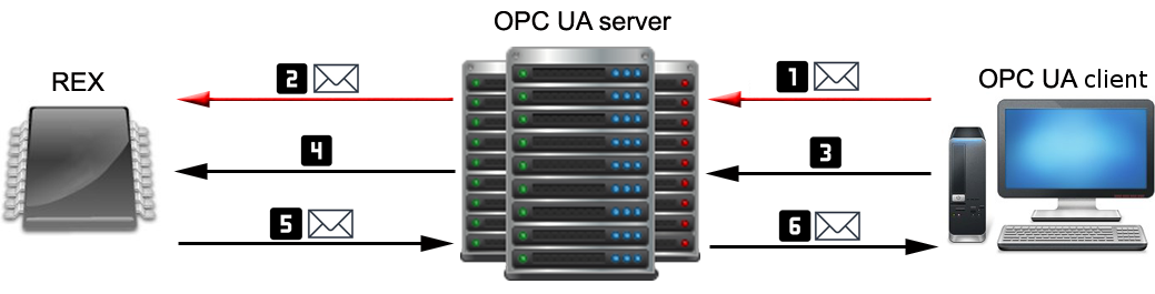

The OPC UA server is connected directly to a REXYGEN runtime core. It shows complete structure of a target algorithm (ie. blocks, variables..) in the address space. The server acquires complete structure of the algorithm during startup and make all runtime variables accessible to clients upon request.
A connection to the target device is maintained and checked periodically. The server tries to reinitialize the connection or reconnect to the target device when the connection is lost or an error occurs. Last acquired values are held and available to clients. Value quality is set appropriately. If the target algorithm is changed, the address space is rebuild appropriately and connected clients are notified.

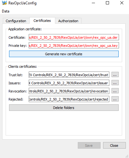

A configuration file, server’s certificate and a private key (if encryption and authentication are required) are needed to successfully run a server. Following steps have to be done in order to start the server:
- Install REXYGEN system with the OPC UA server option enabled.
- Create a configuration file by following these steps:
- Create a certificate if you don’t have one either obtain it by following certificate policy
of your company or generate it yourself
- Using RexOpcUaConfig (viz kapitolu 6.1)
- Using OpenSSL
- Using script /etc/rexcore/rexopcua.d/10-cert.sh

- Set client certificate options if any of configured endpoint uses client certificates:
- Create certificate directories (by RexOpcUaConfig, see 6.1).
- Copy trusted client certificates into the folder specified by the CERTIFICATE_TRUST_LIST_PATH configuration option.

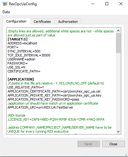

4.4.3 Security
The Security section contains configuration of clients certificates ie. validation options and locations. The section is relevant only when any of the configured endpoints has security options set.
The RexOpcUaConfig configuration tool from the REXYGEN installation may be used to create a server certificate and directories for client certificates.

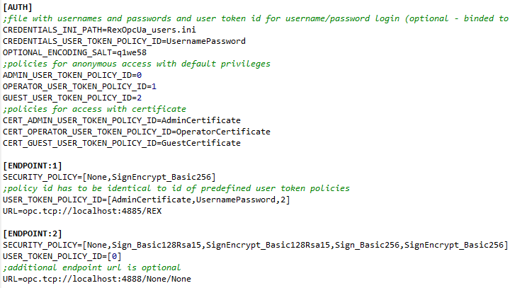

4.4.4 User Token Policy (UTP)
User Token Policy (UTP) sections define allowed authentication and authorization methods. The options are described in the table 4.5. Modification of user accounts and roles is described in chapters 5 and 6.2.
An authentication policy is specified by a client during connection handshake. No credentials are required within an anonymous connection. Otherwise a valid user name and password and/or valid and trustworthy certificate has to be supplied by a client. A certificate validation can be configured in the same way as a certificate validation for secured connection (see table 4.4).
A list of supported authentication policies has to be defined for every endpoint by the option USER_TOKEN_POLICY. An endpoint may support multiple anonymous policies. A client selects a required policy.
A configuration file with user roles, accounts and encrypted passwords has to be provided for username UTP. An optional parameter OPTIONAL_ENCODING_SALT defines an encoding salt of user passwords in the configuration file.
| Field | Typ | Default value | Description |
| USER_TOKEN_POLICY_TYPE | Anonymous, Certificate, Username | – | A type the policy. |
| AUTH_ROLE | Supervisor, Operator, Observer, AuthorizedUser, Anonymous | – | (Anonymous, Certificate) An assigned user role. |
| CREDENTIALS_INI_PATH | File | – | (Username) A configuration file with user roles, accounts. |
| OPTIONAL_ENCODING_SALT | Text | q1we58 | (Username) Encoding salt for user passwords in configuration file. |
| CERTIFICATE_TRUST_LIST_PATH | Directory | – | (Certificate) Folder with trusted client’s certificates. |
| ... | ... | – | (Certificate) Another certificate validation parameters from table 4.4 can be used to configure the validation. |
4.4.5 Endpoint
The Endpoint section contains configuration of OPC UA endpoints that are available for clients. Each subsection in the Endpoint defines a single endpoint and must therefore contain all required configuration options. All configuration options are described in table 4.6.
It is recommended not to use a local IP address for an endpoint when a discovery service is required to work. The endpoint address should have following form:
opc.tcp://<IP adresa | DNS>:<port>[/<endpoint>]

Several configuration templates are provided to make it easier to configure a new instance of the OPC UA server. These configurations may be used as a quick start templates for arbitrary configurations. Following configuration templates are provided:
- Minimal - a minimal configuration with and unsecured endpoint and a running REXYGEN target on localhost,
- Secured_communication - a configuration for secured endpoints without authentication,
- Username_Authentication - a configuration for secured endpoints and authentication with user name and password,
- Certificate_Authentication - a configuration for secured endpoints and authentication with client certificates,
- Multi_Authentication - a configuration for multiple authentication policies,
- Endpoints - a configuration with two endpoints,
- Discovery - a configuration with registration to a discovery server,
- Licence - a configuration with defined licensing key,
- Full - a complete configuration.
It is recommended to always modify parameters ADDRESS, COMPANY_URI_NAME, PROJECT_URI_NAME and INSTANCE_URI_NAME.

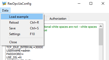

RexOpcUaConfig is a graphical configuration tool of the OPC UA server for REXYGEN. It simplifies a process of a server configuration. It provides a certificate generation, ini file modification and administration of user accounts. Several example configurations are provided for beginners.
A whole content of the configuration ini file is shown on the Configuration tab, see picture 6.1). A content may be modified by a user and saved. Configuration is checked for common errors before it is saved. All errors found are listed in the Errors tab.
6.1 Certificates
Administration of server and client certificates is provided on the Certificates tab, see picture 6.2. All file paths are obtained from the configuration file. The configuration file must be present and all file paths must be valid, otherwise the tab is filled with a red color.
Client certificates are stored among various directories. RexOpcUaConfig makes it possible to create, open and delete these directories. Trusted client certificates are stored in the Trusted folder. All certificates of clients that tried to connect to the server and were rejected are stored in the Rejected directory.

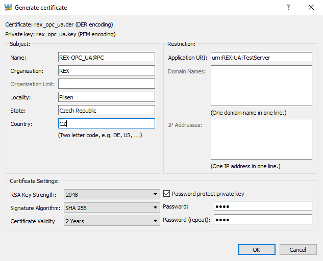

A special dialog is provided for certificate creation. The Passsword and Application URI fields are filled by values defined by APPLICATION_PRIVATE_KEY_PASSWORD a APPLICATION_URI configuration options.
The Subject field contains an arbitrary text. The Restriction field contains an IP address or domain that the certificate is bound to. The Application URI must match APPLICATION_URI configuration option. Certificate Settings affect certificate’s validity and used cipher.
A destination of generated file is is shown on Certificates tab, see picture 6.2. PEM and DER file format are used for generated certificate file and private key file.

The Authorization tab (see picture 6.4) contains settings for authentication and authorization. The tab is visible only when the CREDENTIALS_INI_PATH is set and valid. All user accounts are stored in this configuration file.
There is a simple graphical interface for creation of a user account (picture 6.5), modification (picture 6.6) and deletion.

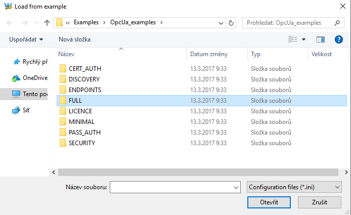

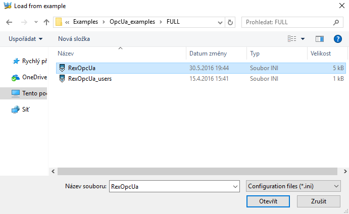

6.3 Configuration examples
Several simple configuration templates are provided for beginners. (see chapter 4.5). An example configuration may be used as a quick start template for arbitrary configurations (see pictures 6.7, 6.8 and 6.9).
No template of configuration file for user accounts exists and the file must always be created from scratch. Please check, that OPTIONAL_ENCODING_SALT is set appropriately when copying or re-using the configuration file.

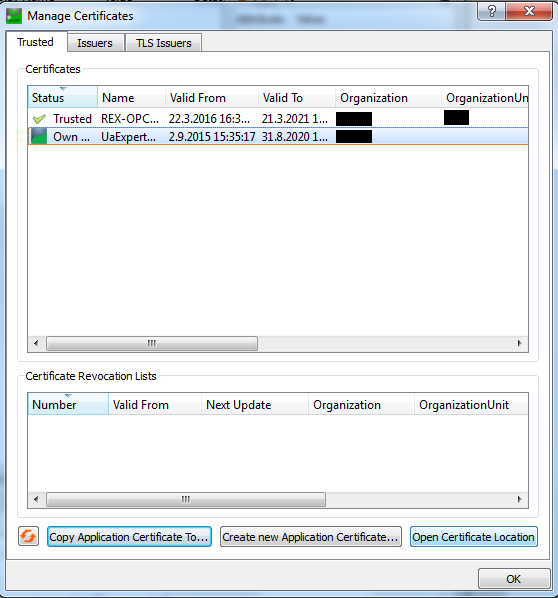

UaExpert invokes a certificate creation on a first startup. A generated certificate has to be copied to the server’s trusted certificates directory if an authentication using certificate is requested using option Settings > Manage Certificates > Copy Application Certificate To... (see picture 7.4).

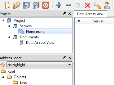

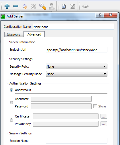

A connection with OPC UA server is established by clicking on "+" button. A dialog for connection configuration is opened. Advanced connection options are set in tab Advanced (see picture 7.5).
An established and working connection is indicated by a connected plug (see picture 7.7). A connection may be closed (unconnected plug) and re-established again. Connection options may be changed only in disconnected state (icon with a key). Authentication policy may be changed at any time (icon with a user). UaExper may have several connections established at the same time. Client configuration (including connections, monitored items etc.) may be saved and later loaded again.

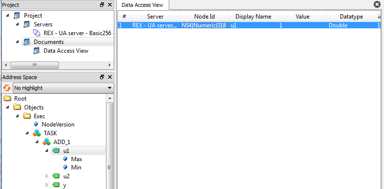

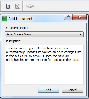

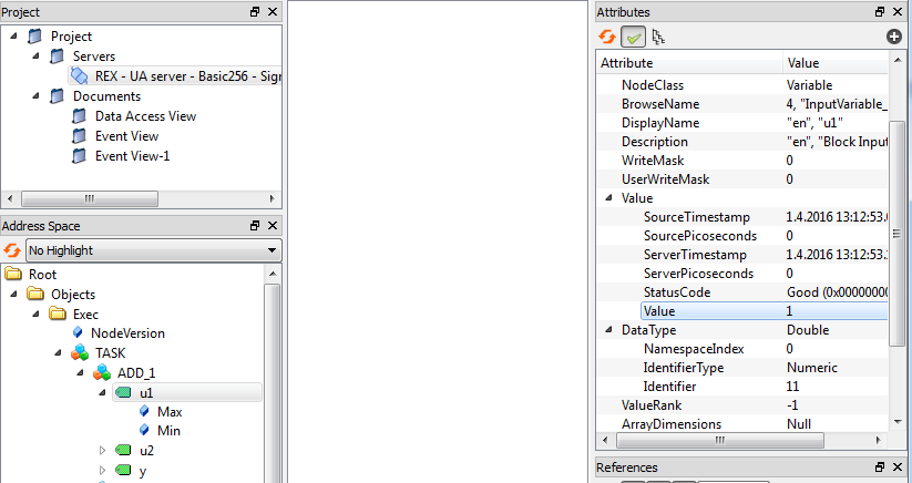

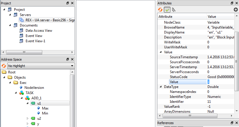

A Data Access View document has to be created by clicking on a document icon, selecting option Data Access View and then clicking on Add (see picture 7.8). To monitor an item simply drag and drop corresponding node from address space to the document (see picture 7.9). A monitoring of the item starts immediately. The item may be deleted at any time. A value may be written to a monitored item by double-clicking on the item in the document and entering new value(see picture 7.10).

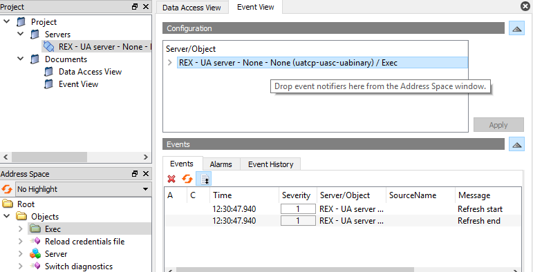

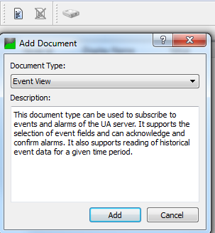

A Event View document has to be created by clicking on a document icon, selecting option Event View and then clicking on Add (see picture 7.11). To monitor an item simply drag and drop corresponding node from address space to the Configuration area (see picture 7.12). All monitored events are listed in Events area. Event details are shown in the Details area. It is recommended to always monitor the Exec and the Server nodes of the OPC UA server for REXYGEN.

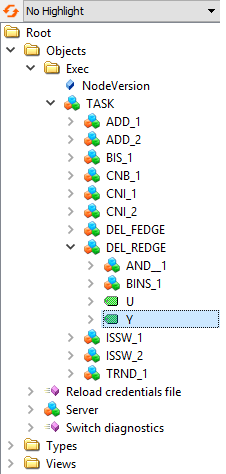

A simple read operation in UaExpert is performed by clicking on a node in the address space tree view. A value is shown in the right part of the node, see picture 7.13. A write operation is invoked by double-clicking on a node, see picture 7.14.

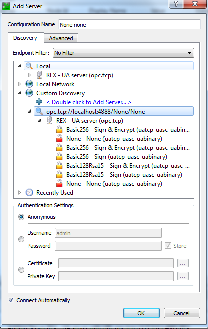

UaExpert supports a discovery service and shows all available OPC UA endpoints of registered servers (see picture 7.15). A user may expand a requested server in the tree view, select requested operation and set up an authentication policy to establish a connection. UaExper always checks a Local Discovery Server (LDS), a freely available discovery server (see chapter 4.4.6). Another option is to register a custom discovery server or OPC UA server directly.

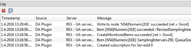

Inspect application logs that are available in the bottom panel (see picture 7.16) if a problem occurs with a connection.

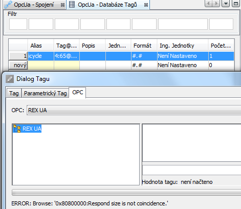

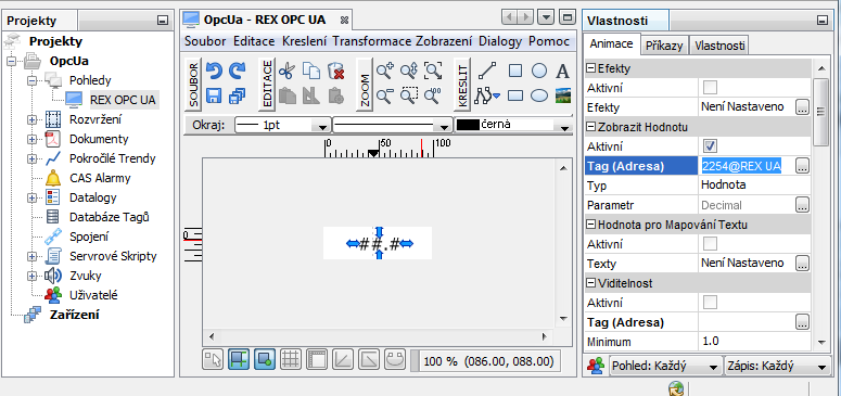

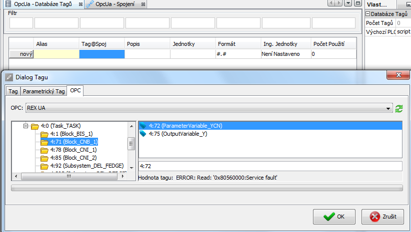

mySCADA is an Human-Machine Interface tool that supports OPC UA. Not all OPC UA options are supported by mySCADA.
First, a new project has to be created in myPROJECT designer. Then open a connection tab, insert a new connection a select OPC UA. A configuration dialog is opened in which a connection with OPC UA is set, see picture 7.17.
A data tag has to be defined in the next step. The tag contains a reference to a single node on OPC UA server that contains the requested value, see picture 7.18. The tag may be then used to show a value in HMI application, see picture 7.19. Download a final project to the device and use myView to show it.

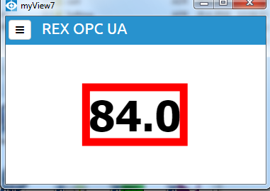

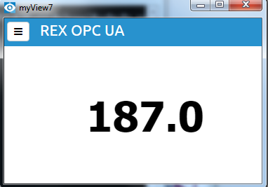

Use myView to show HMI on a device. A proper value is shown and updated from OPC UA server, see picture 7.20. An error is indicated when a connection error occurs, authentication fails or a tag is not valid, see picture 7.25.

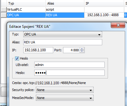

An endpoint has to have a /None/None suffix to mySCADA work properly with unencrypted connection. A policy ID for anonymous login must be set to zero, see picture 7.1.

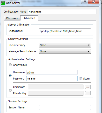

To configure user name and password authentication policy a UserNameIdentityToken policy has to be set (see pictures 7.22 and 7.23) and user name and password must be supplied (see picture 7.24).
An error is indicated when authentication fails, see picture 7.25.
